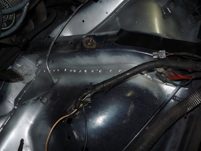

I'm slowly trying to spot weld the seams in the engine bay. I figured, it can only help stiffen the front end. Especially the seams at the shock towers.
Finally found the correct heat setting for my MIG welder so that the beads would actually not be too big (not hot enough originally).

Re: Spot welding engine bay
Well I jacked up the front end of the car and place jack stands underneath. Much less flexing and the doors can open and close properly. I'm sure there is still quite a bit of flex but I may have reduced it. Remember I just spot welded many points, not seam weld, at the strut towers and the the other piece behind the tower close to the firewall.

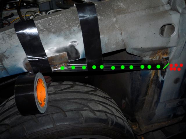

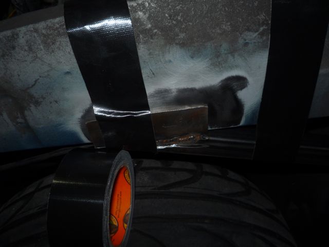

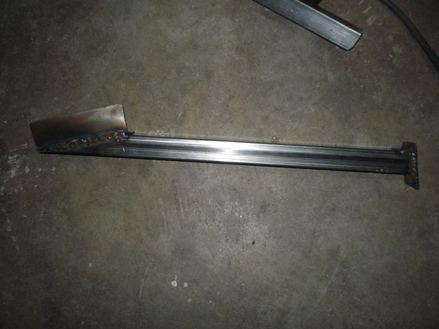

Some updated pics of inner fender brace. I think a brace is a bad idea for a full time street car, you will compromise the crumple zone. But for a 80% track car, not too bad of an idea. But for a race car, don't wast time with this, go with a full cage which extends into the engine bay.
I intend to only put a few spot welds between the brace and the body of the car in case I don't like the idea and decide to take it off.
Opinions?
Opinions?
ah I completely missed out on this one.
Z, hate to say it but your spot welding isn't really effective.
When you really want to add stiffness, you need connected the sheets together without a bend in the sheet. And make it look like a square section tube.
So weld as close as possible to the vertical sheets metal. Best would be, mill some small holes from the wheel side of the fender and weld from there, which is pretty difficult to do.
Easiest/practical to weld, melt though the upper sheet as close as possible to the bend, make sure the melt goes through the lower sheet.
The spot welding done by alfa is really bad, so everything you add helps
Best would be to let the tube protrude into the a-pillar. And weld it onto the sheet it hits, plus around the hole you make in the a-pillar. Also spot weld the tube to the side wall (red dots).
To save some weight you could make some holes (sort off like the green dots) in the vertical wall off the square tube.
Hole diameter ~ 60% of the inner square diameter of the tube and 3x hole diameter (hart to hart of the hole) pith. But make sure you don't have a hole underneath the sheets of the shock towers.
Actually this is what I meant, it is very easy to melt two sheet together like this. The hole drilling is the hard part. Warping isn't an issue if you take it easy.I think what I can do is from the wheel side is drill a few holes 1/2 way, till it hits the other sheet metal. Then spot weld and melt the 2 sheet metals together.
First of all, same story as the seam welding. Try to let the (vertical) side wall of the square tube align with the vertical sheet of the a-pillar.What do you think about the brace?
