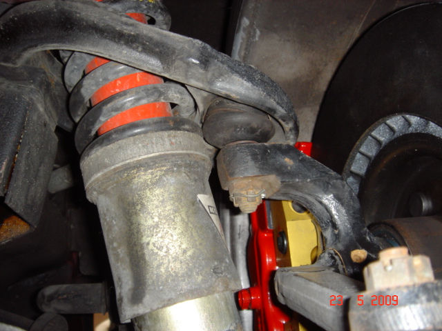

as promised
sz 001.jpg (154.92 KiB) Viewed 8680 times

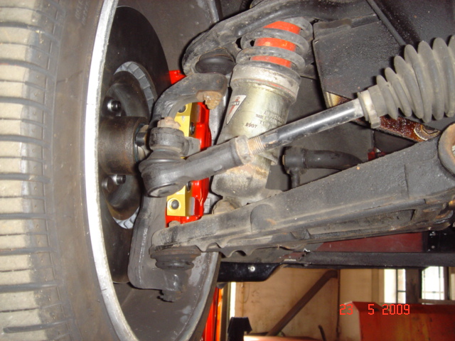

one more
hope this will answer your question
sz 003.jpg (143.6 KiB) Viewed 8677 times
Bruce
Posts: 187
Location: Four Ashes, UK
Re: Message for RZ (re suspension)
Post by Bruce »
Thanks.
Interesting bump-stops acting against the top arms. GTV6 and early 75's had them facing against the lower arm, right?
Zagato
Posts: 55
Joined: Fri Mar 11, 2005 7:42 am
Post by Zagato »
Bruce wrote:Thanks.
No, the older cars Alfetta, Giulietta, GTV6 up to app late -85 has bumpstops like that, Later GTV6 and 75 has them on the shocks.
