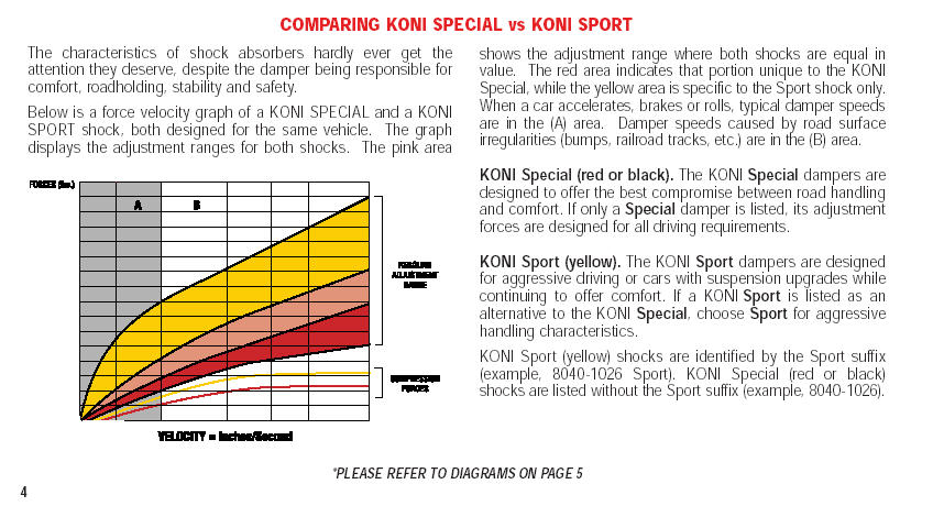

Take a look at this PDF, there is really nice comparison between reds and yellow ones. :wink:
Rock on! :D

You haven't seen this? :? You might try right click on that link and choose option "Save as..."
There's also ID table for various codes on each Koni shock explaining exactly what you have...
