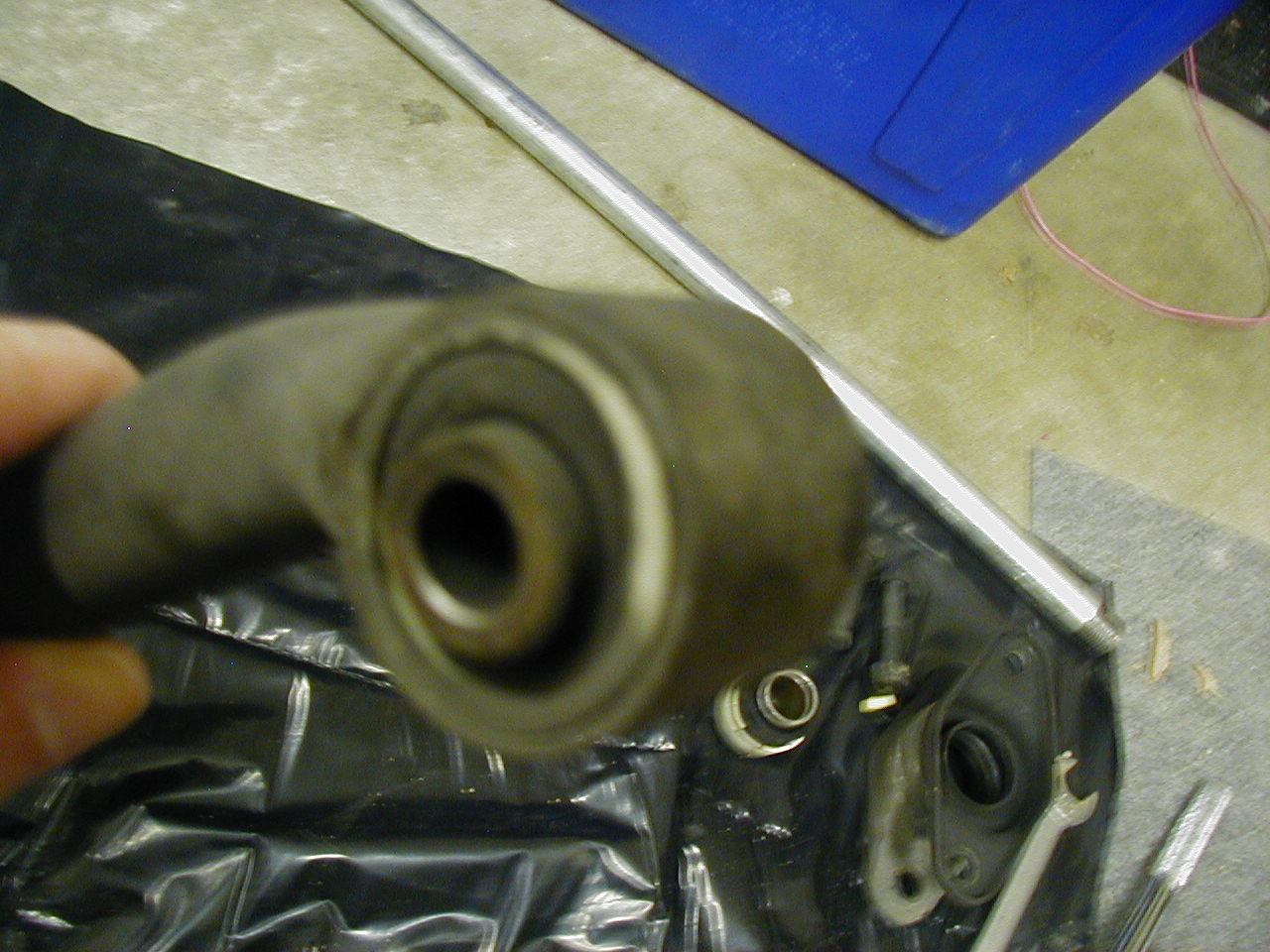

PS _ here is what the end link bushing at the Watts looked like!

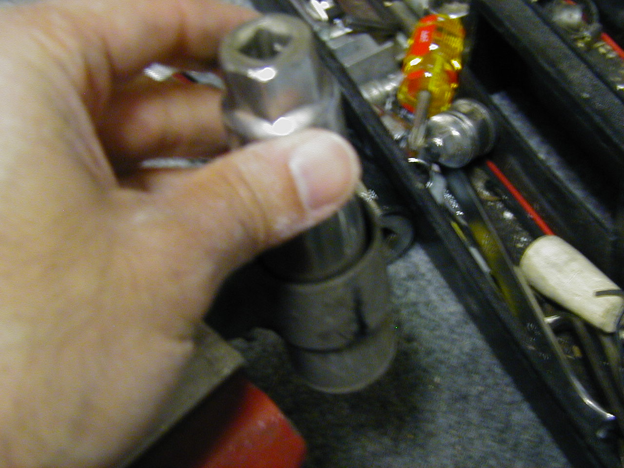

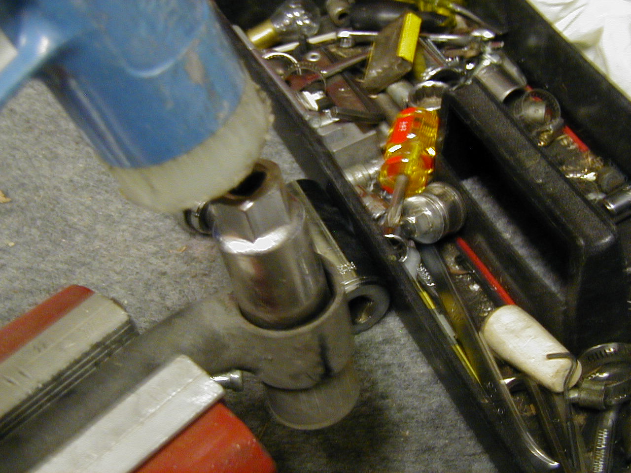

Pounded out the end link bushings using a sparkplug socket that was about the same diameter as the bushing. Note that one end of the bushing is camfered - when removing you want to drive it out from this end ... pound from this end. With a good mallet mine came out easily.
Watts center bushing was also driven out pretty easily, again using a large socket and mallet.
GV
Driving out the bearing

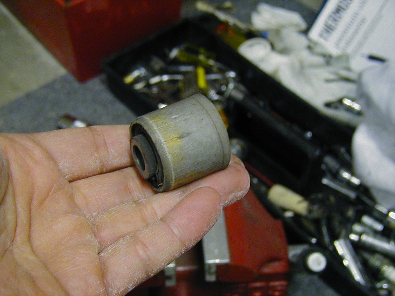

Here's a removed endlink bushing - note the one side has a camfered edge - this is the side you want to hammer it out from.

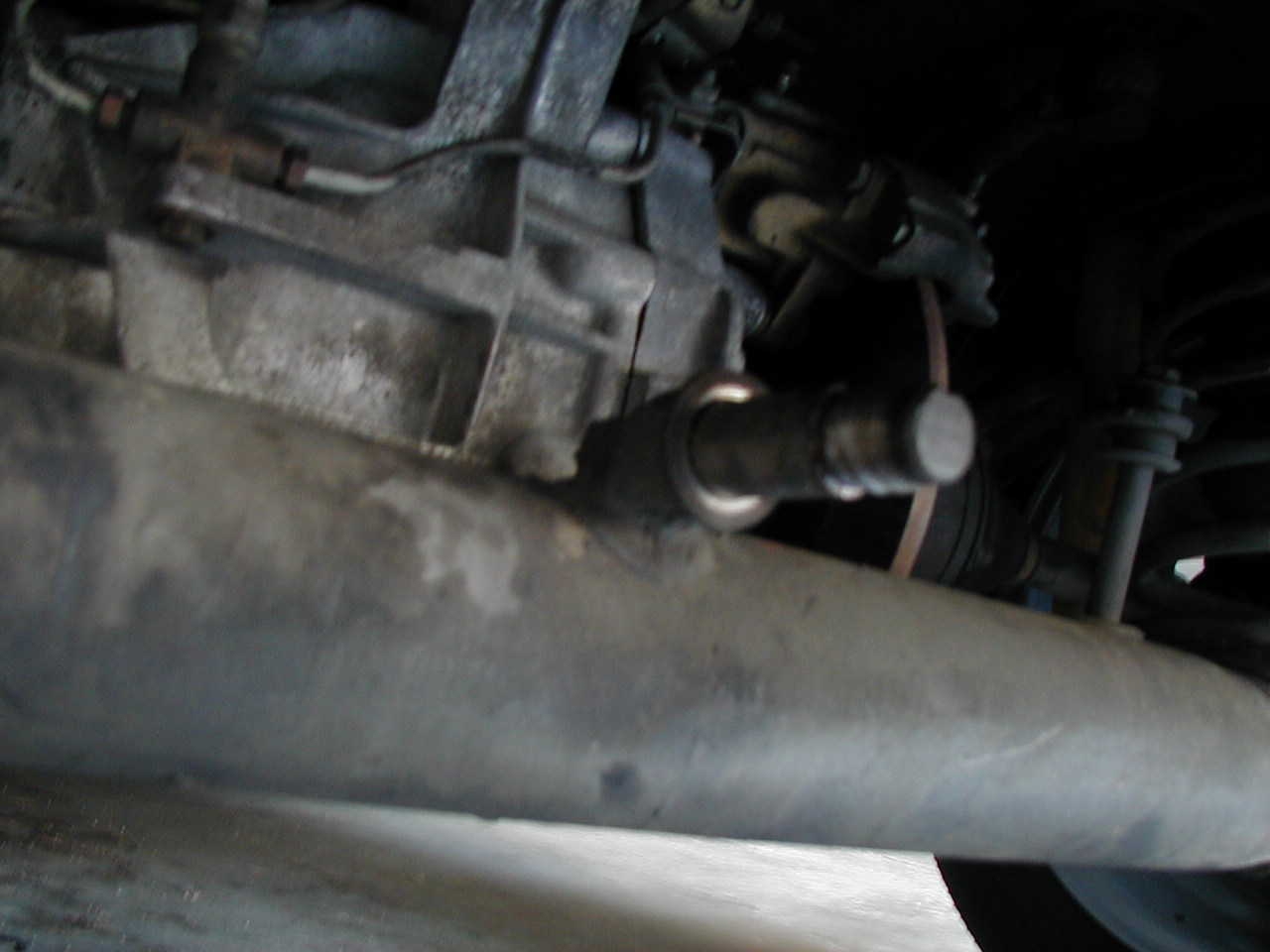

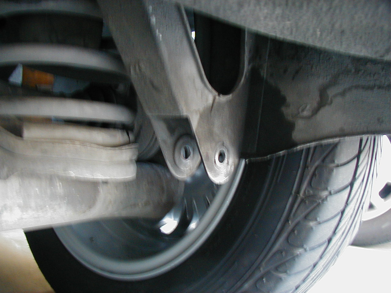

Photos of dedion with Watts removed
GV
Passenger side Endlink point
Center pivot with Watts removed
