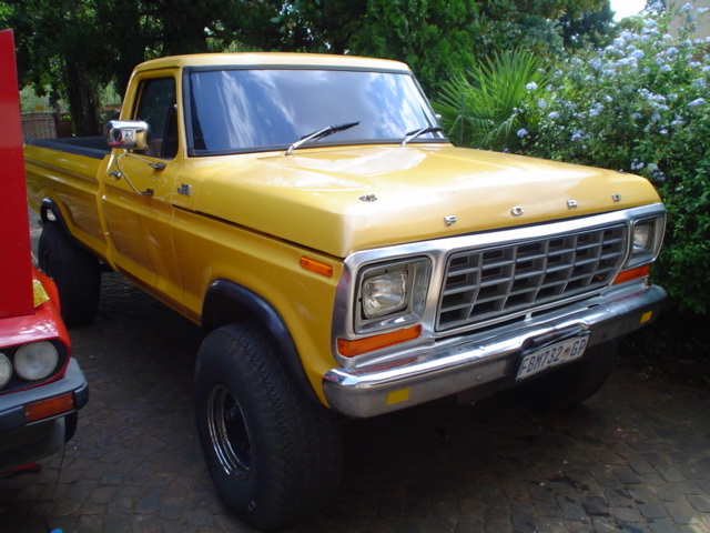

James,Got myself a new toy...1977 model,running a Cummins 6l diesel turbo..
Some tweaks by Cummins themselves,1200 Nm torque!!
Could make for a nice tow truck...

- DSC02085.JPG (152.51 KiB) Viewed 7819 times
Damn!
That thing would get you some serious respect where I am from... Or where I currently live, for that matter. Diesels are rare here and all the guys want one.
I sold my F350 last summer
For the record, I am the skinny guy with the clown outfit in the photo, not the Mexican pansone with the big gut. He brought the tow truck to give the Alfa a jump... (In Spanish the word for gut is pansa, and the word to describe a guy with a gut is pansone. I came here to learn such things).

Not only will it be good for towing, it will be a good tool if SA gets crazier and you need to go Mad Max...
