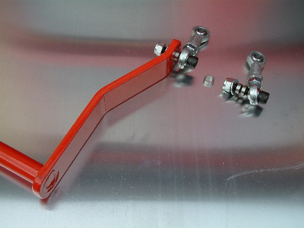

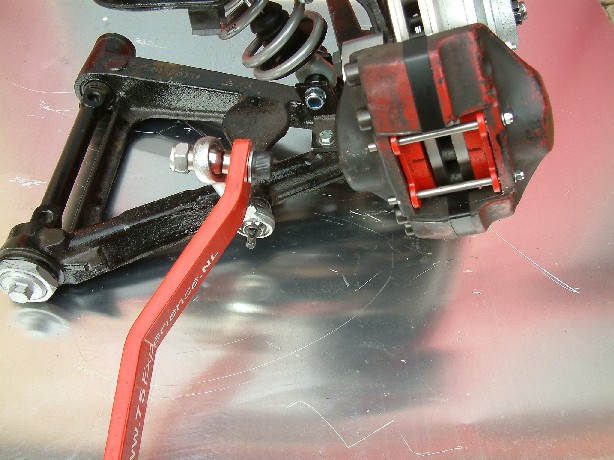

The bars are secured by two bushed center-mounts and the reaction arms attach to the lower control arms - here - a couple of shots so that we can be on the same page...

junglejustice
Posts: 624
Location: Granolaville, WA
Post by junglejustice »
...the only part not visible here are the two center-mount clamps that secure the horizontal section of the bar to the front cross-member...
