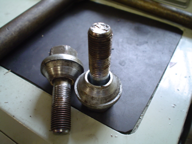

Jose,MAKE them yourself.....a lathe,mild steel for the conical washer,and high tensile wheel bolts....
DSC00003 (2).JPG (131.9 KiB) Viewed 5154 times
