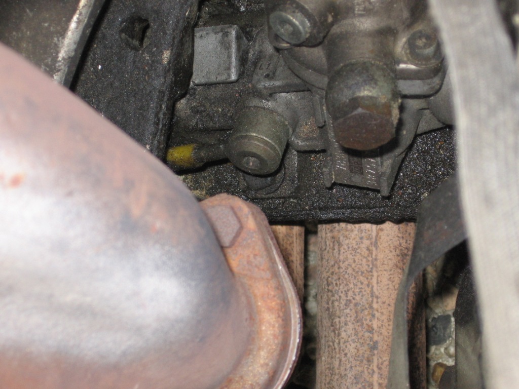

Has anyone taken a ps box apart? What must be removed to make it manual? I just want a little preview as I'll find out all about this when a buddy brings me his spare ps box.
Jim,
I've done this conversion with the steering box of the ring TS.
Can't find any pictures of it , will try to take some pics of it in my car tomorrow.
It is pretty straight forward.
Pull all connections off. Let the fluid out. Put a nice amount of grease (0.1l) in and make sure you grease the teeth of the rack rail (good word???) very well. I also use CV joint grease. When you move the rack rail you feel where the cylinder pushes air out (different outlet for left and right movement). Make a balance tube between those two chambers and thats it!
Works very well. Only hard to park the car after the conversion. :lol: Another reason to give the front some more camber :mrgreen:

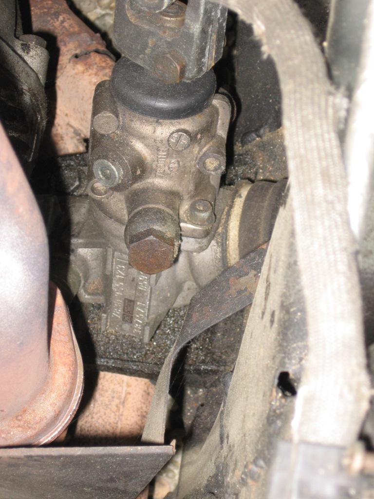

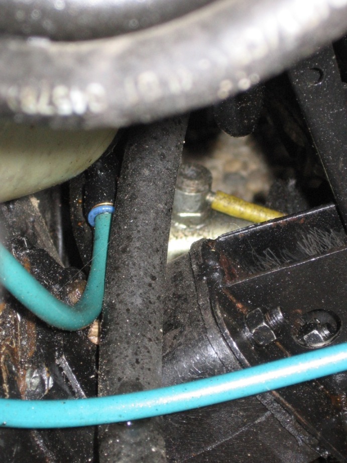

Maurizio
Posts: 680
Post by Maurizio »
I was to lazy to pull the sealing tube.
The pic's I promised, a bit difficult to see how it is done
hmmm got make the leaking crank seal at the front side :oops:
yellow balance tube passenger side
yellow tube is the balance tube on the drivers side
blocked holes
