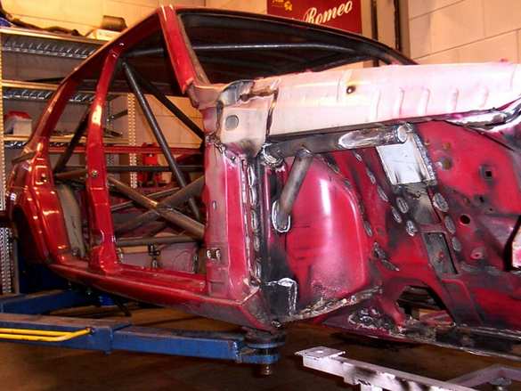

Giuliettaevo2 wrote:here some bracing of the lower parts...
Wow, whole new chassis rails 8) .
Dedicated track car?
Dennis
Posts: 194
Re: Chassis Bracing and Seam Welding
Post by Dennis »
no, this is a streetcar. The guy who owned the car works in a raceteam that modifies it's racecars this way. There is additional bracing from the enginebay aswell, on the racecars that is.
This setup is also on my racecar. It absolutely transforms the handling.
'81 GTV6 3.0 QV
'91 75 TS (track)
'02 BMW 330i Touring
Sits below the original ones? Or is the engine raised in the pictures? Control arm fixing points lowered? :?:
Or is it going inside the original rail? Why is the sump lower surface so different in height to what I'm used to see? :?
Duk
Posts: 541
Location: South Australia
Post by Duk »
Mats wrote:Or is it going inside the original rail? Why is the sump lower surface so different in height to what I'm used to see? :?
Looks like new rails are inside the originals to me.
Maybe the sump looking strange is a bit of an optical illusion. Because of the new rails extending forwards and staying horizontal when you're use to seeing the chassis sweep up :? Maybe :?:
Still quite amazed at how major that is for a road car.
Maurizio
Posts: 680
Post by Maurizio »
Mats wrote:Sits below the original ones? Or is the engine raised in the pictures? Control arm fixing points lowered? :?:
Original rail was opened and square tube shoved in, rest is standard, strange look is from the foto angle.
I had interest in the car (a lot other nice upgrades on this TS) but this tubing made it a no-no for me.
I don't like to comment on something when there is no one who can defend his own work.
But the need/effectiveness/outcome on this particular car wasn't done very nicely in my book. If you go into so much trouble with converting, I like to recognize knowledge behind it.
The basic idea is good but it has to be done with more care for detail.
So it is wise to have some decent knowledge of strength / stiffness and how to couple new and original steel by welding in an efficient way.

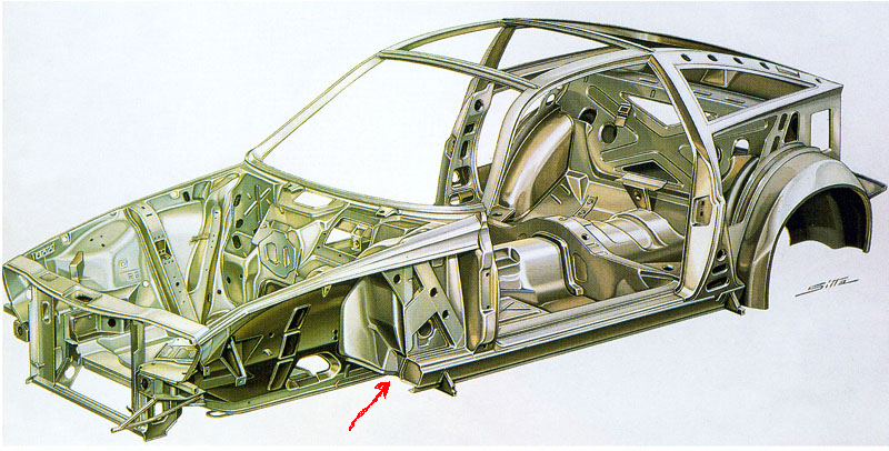

While i was listening to Billy Idol (white wedding) i took a look at the picture (the one that i attached) of the SZ Chassis. It seems to be quite different than the ordinary 116 chassis and i don't mean the obvious, that it is a 2 door coupe, what i think is that the front part is "boxed" , the A pillar is connected to the V of the fender via this "box". I can't explain it better so have a look yourself guys.
cheers
follow the red arrow neo
SZ Rahmen_Zwo.jpg (131.6 KiB) Viewed 8805 times

Very interesting considering every thing I'd been able to find on the SZ says that they were built on a shortened standard 75 chassis.

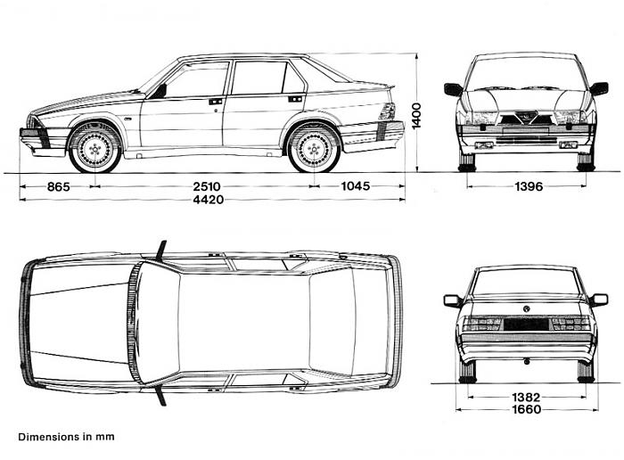

Since you asked, I had a quick web search and found this http://www.carfolio.com/specifications/ ... dimensions, but it's the same wheel base dimentions as the pic. Strange as I'd read more than once that they were shorter http://www.alfaworkshop.co.uk/alfa_sz.shtml:

SZ Track: front 1464 mm rear 1426 mm
75 Track: front 1396 mm rear 1382 mm
Is the difference in track purely from wheel offset?
68mm more track width would make noticable differance to the behaviour of the front. But a 34mm change to the wheel offset would have a pretty major effect on the scrub radius of the steering.

Duk wrote:SZ Track: front 1464 mm rear 1426 mm
An sz runs 7x16 et 7 in front and 8x16 et 20 wheels in the back.
I have run these wheels on my V6 and it works pretty well.
Only the 75 chassis is at the front not that happy with the wide wheels :lol:
They quote a lot of different tracks in the workshop manuals due to the wheels, so yes, I'd say the wheels.
