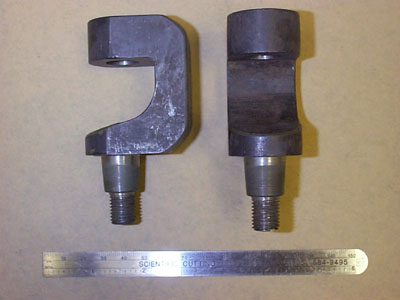

Ok spamming post today, but need to exploit that little free time I have. I guess I'll be running knuckles raisers. Sure not as good as drop spindles, but cost wise much more available for me atm and still better than nothing. Found the pics of autodelta knuckle raisers for 105 chassis. Now how much would you "raise" over the stock spindle?
Second question is, provided that I'll have the raiser installed, will I need to do any mods for the caster rod? The upper control arm will be way above the level, where caster arm is mounted into the inner fender, I thought of bending it downwards any other ideas?

I have knuckle risers in my 75 (road car).PietereQ wrote:Second question is, provided that I'll have the raiser installed, will I need to do any mods for the caster rod? The upper control arm will be way above the level, where caster arm is mounted into the inner fender, I thought of bending it downwards any other ideas?
1st thing I will say is that I (personally) wouldn't use them over correctly made drop spindles if your car is lowered significantly.
I raised the front of my car up from the lowered state I bought her in. I'm guessing that she is lower than a standard 75, but far from the slammed 'drift slead wanna be' that the previous owner had her set to.
My LCAs are pretty close to horizontal when she is fully dressed (in pieces ATM).
I raised the front of my car more because of ground clearance issues than any other reason, but I do believe that for a significantly lowered car, well made drop spindles would be better suited.
I bought my KR from Vince Sharp here in Australia. He provides spacers, so that while the top ball joint is raised from standard (about 35mm I believe) the actual top control arm angle looks to be close to original for the ride height of the car.
My guess is that Vince added these spacers so that the front suspension doesn't end up with large amounts of static negative camber. The wheel alignment guy had to add a large number of shims just to get 1 degree of static negative camber.
I haven't had any issues with caster arms. But I also don't thnk that you would even if the spacers weren't fitted, and the top control arm was more in line with the 'actual top inner suspension pivot/top ball joint relationship'.
Hope that helps

Hey thanks, but i cannot really see the knuckle rakser to be just 3,5 cm tall, more like 6 cm at least (just to allow some space for pivot nut)
