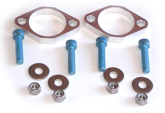

That's just the way Mats shows it, but if you don't want to drill the car, you can use a thicker adapter like the ones in the picture. If youwant to do it yourself, take an exhaust gasket for the right shape :wink:

8) The original design of the performatec kit is from me.
I've got a set adaptor plates of the newer design on stock.
Aluminium adaptor for the wheel side and a stainless steel clamp plate for the motor bay side.

In any case, what's the thickness of the Performatek's plates? 10mm?
'84 Red GTV6 3.0
Maurizio
Posts: 680
Post by Maurizio »
I'm not sure what thickness my first design had, think that the drawing I sent to Andy was 8 or 10 mm :?
The new set is 8 mm thick alu adaptor plate and 4 mm clamp plate.
Do I want to sell, don't want to screw up this nice site with commercial blabla :x , I'll do a PM.
